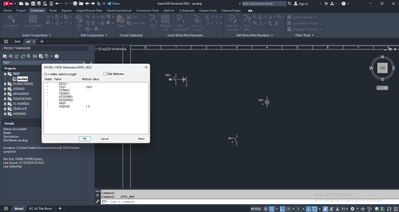

Hello.
I have created a parent symbol (push button with lamp) that I want to show (cross-references) the location of the children: lamp and other contacts. To do this, I placed the attributes XREF and XREFNO on the parent, with the purpose of referencing the lamp and an open contact respectively; however, the lamp is not referenced.
I am attaching images of the problem and the exploded symbols so that the attributes placed on the symbols can be seen.
Thank you in advance for your time and help.
Best regards.

Message 3 of 14
pgarciadlc
Hi @arshdeepsingh404
I use text format cross reference. Separator character is a space (for multi text cross reference).
The reference for the lamp does not appear in the attribute list.
When I use AEXREF with pick I get the following:
It seems that the XREF of the parent is not called by the child, however, the child does have the XREF of the parent.

Message 13 of 14
arshdeepsingh404
Hi @pgarciadlc
After some testing, I was finally able to get your version of the symbol working.
It turns out that you need all there attributes XREF, XREFNO, XREFNC in the symbol to make it work.
I inserted the XREFNC attribute and set the Invisible property to Yes as you are not displaying it in your symbol.
I have attached the modified version your block. Let mw know how this works out.
Good Luck!

pgarciadlc
Thank you. That was the omission that did not allow the child to be referenced in the parent.
Regards,
