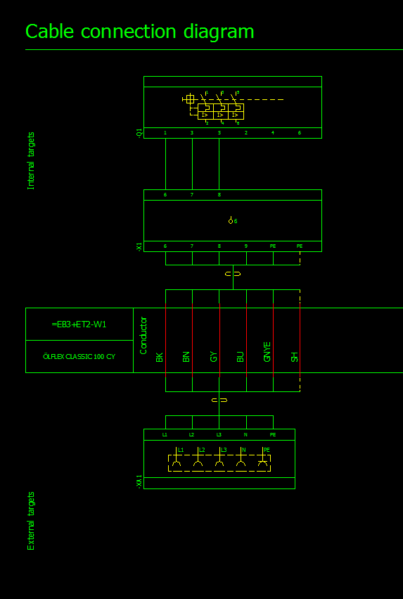

Can AutoCAD E create a termination drawing/diagram. Not a wiring diagram, not a report, a drawing which shows cabling and termination information from MCC / switchboard to field devices.

No. OOTB AutoCAD Electrical cannot do that.

Okay, so Not "OOTB" but does that mean it can somehow?
Message 4 of 10
rhesusminus
AutoCAD Electrical have an API that you can use to extract the data needed. Then you can do some code to create the graphics.

Icemanau
It depends on what you are using to get the external wires into the MCC.
If you are using terminals, you could always use the TSE to show the terminal strip with the wire numbers showing.
Depending on how you configure the wire number display, you should be able to get what you need.
 These terminals are from one of our projects and the client wanted the connection information of the external terminal strips.
Also shown are 4 clip on shrouds for some terminals that are 110VAC.
If you anything other than the terminals, then you will need to do it manually. I would suggest using the Cable Markers and the Fan In/Out tools to show the different cables/cores.

ccad2509
something like this
Message 9 of 10
Thanks for the examples.
I can see the value of them but what we are looking for is typically like what I've attached.
