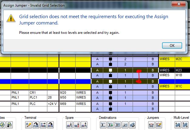

In ACADE 2015.
I have a schematic that has muliple instances of power and ground terminal blocks, each with a single terminal number repeated.
In the panel layout, the terminal strip editor does not allow me to combine the wire connections to the fewest possible terminal blocks.
I am also having difficulty making two wire connections into external connections on the same terminal block.
I cannot associate some terminals to terminals that clearly have a free spot available.
I know these issues exist with the TSE.
Does anyone have an alternative tool for showing terminal blocks and wire connections?
Or, Is there ways to set up schematic terminal blocks to trick the TSE, i.e. a seperate terminal block symbol for bus wiring.

To make matters more difficult.  It seems that terminals that are automatically added to fullfil the connection requirements (because I need all cables to be external connections), jumpers cannot be added to connect the terminal blocks that were added to the ones they came from.

First problem you mentioned, reducing the number of terminals to the lowest number of connections.
The TSE will show at a minimum, ALL the terminals that have symbols in the schematic. To reduce the number of terminals, you need to remove the schematic symbol as well.
Second Problem, The section you highlighted shows as TWO SEPERATE terminals. The TSE is not designed to move wires from terminl to terminal.
To change this, you need to edit the schematic.
ASSOCIATE is used to indicate multi level terminals, not to indicate that the terminals are being used as a bus.
To have terminals used as a bus, you need to use the JUMPER tool and select the terminals that way.
You can always set up a wire layer named JUMPER to connect the terminals with as well.
Check the terminal you have specified. If the terminal only allows one connection per side, then the TSE will add extra terminals as required to fulfill the connections accordingly.
You problem with the Jumper error is that the terminal is assigned as a multi level terminal and the TSE is looking for another level to link to and not another terminal.
