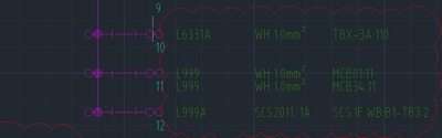

I think this counts as a single level terminal with 2 wires per connection
I would show as just one terminal schematic with connections like this
or this, depending on your preference
you can control where the wires land in the TSE and graphically show the points if you require, I've not been so specific about my A and B terminations

galashkina
Thanks!
The option you have suggested is simpler and more convenient.
However, Phoenix Contact has come up with a more complex design, and customers choose this design. ☹️

Is this terminal list not implying the terminal will take 16 wires?!
I hope I haven't misunderstood the database!
could you achieve what you need with a 2 level terminal, 1 wire per conn, PINL A,B, PINR C,D (maybe)? although this would only allow 2 schematic terminals to be shown, and if you wanted to refer to the whole terminal as single number you would never be able to renumber the terminals

testsubject
I use a similar terminal from Rockwell. 1492-L3Q.
This is how I draw it.
I treat it like a 2 tier terminal block.: pins 3 and 4 are the bottom (outside) and pins 1 and 2 are the top (Inside).
This is NFPA style.
