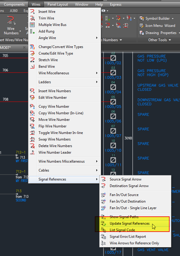

Developing the CODE syntax can be a magical mystery tour.  What I mean is that it can be tailored to fit just about any  style or application.  It just boils down to what works best for you.  Power distribution can be straight forward but you may need to use a little imagination for multi-contact devices or PLC I/O points or multi-pin connectors.  Have a little fun with it.
As far as to/from working correctly, when first inserted they should automatically update cross ref.  Later on if you move or edit them you may need to Rebuild Project Database, and THEN run the manual update.  And just as a reminder, the arrows use the Sheet reference numbering, which beans if you insert an arrow where there is no Sheet ref. numbers you may only get ?? for the ref.  That is normal, ACE is telling you it is pointing somewhere but it does not know where.

Rebuild the database when the arrows have been moved or edited and ACE is confused
Update active drawing and/or project and the world is good
