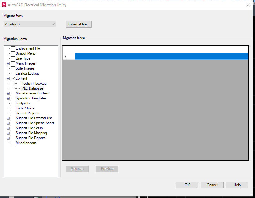

I have autocad electrical 2024 installed on my machine. It does not have the allen bradley 5069 modules available in the PLC Database file. However, I do have an old copy of the ACE_PLC database file from a previous version of autocad. is there an easy way to add the information from the old file to the new file or replace it with the old one so I don't have to add them all again?

Use the Migration Utility:
https://help.autodesk.com/view/ACAD_E/2024/ENU/?guid=GUID-63EED56F-9EBA-470C-A6BE-079F26BB7119
You can merge the databases together there.

When I try to use the migration utility I get the following error
 I can then go to custom and select the pLC database but I am not seeing how to select the 2 files to combine.
Message 4 of 22
rhesusminus
There sure is something missing there 😂

Message 5 of 22
rhesusminus
So, I see this:
Are your aedata folder and wd.env located on a server or locally? That error message apparently creates some problem...

bSZCZEPANSKI
Yes under c:program files\autodesk\autocad 2024\support\en-us\ The information is there in the file but nothing shows up in the insert plc from database utility. There are 2 tables for each module. The first one looks like it defines the module and the second one shows the terminals and attributes. Is there something else that may be missing?

rhesusminus
But.. That would be the wrong location.
Your files should be in "Documents\Acade 2024\AeData\en-US\Plc"
Do you have some strange folder redirection going on? So that your "Documents" folder isn't located in "C:\Users\[username]\Documents" ?

bSZCZEPANSKI
The same tables appear in that location as well. perhaps the wd.env file needs to be update to hard code it to ignore other copies. do you know where I would add it in that file? I am a bit rusty changing things. we have been using a network file at the previous employer and where I am now has been a copy and paste operation. I am trying to convert everything over to Autocad electrical

bSZCZEPANSKI
Is autocad still using a PLC_MSG file on 2023? If so, that is the problem I don't appear to have it
Message 18 of 22
rhesusminus
haven't heard of PLC_MSG... Do you mean ACE_PLC.mdb ?
It should be located in "Documents\Acade 2024\AeData\en-US\Plc"
Again:

bSZCZEPANSKI
No it is listed in the Autocad electrical 2022 release.  I haven't heard of it either but when I do a search, nothing comes up on my C; Drive
Message 20 of 22
rhesusminus
PLC_MSG is not a file. It's a table within the ACE_PLC.MDB file.
