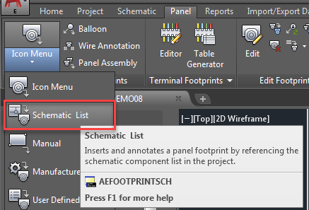

PatMurnen_Adsk
I didn't try this method but I believe you are ending up following my #2 suggestion in my previous post:
  • insert the panel footprint with the exact same catalog values as the schematic. If the schematic has a main catalog and 1 multiple catalog value, then the footprint should have the same.
You can achieve this same thing by using the Schematic List command on the Panel ribbon tab as shown here -
Just make sure not to check the option Multiple Catalog as shown here -
Then each panel footprint inserted will carry all the catalog information from the schematic component.
Either method should provide all the catalog information in the Panel BOM report since the panel footprint carries it all.
