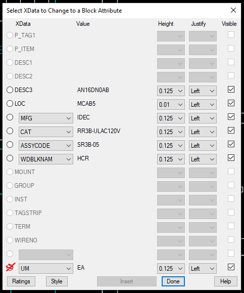

Hi I notice the original question from testsubject and JeffatPrimex reply but i am still having problems.
What I need to do is lets say I got multiple catalogue data and lets say
my 02 has a textvalue with the following RATING10=M12 BK;RATING11=MIR-10M12N;RATING12=EPN350/M12
What kind of attribute i need to create in the symbol editor to refer to these contents ?
I have try RATING0210/RATING210/RATING110/RATING10/RATING1210/RATING10210 but nothing picks up the se contents from 02

Just so we have the "tree" properly called out, the Main part number is level 01 and all Multi-catalog parts (01-99) are level 02 for the nesting of fields.
The Level 01 attributes do not have a number associated with them:
MFG
CAT
UM
CNT
ITEM
WDBLKNAM
ASSYCODE
There are only 7 fields in the data base that are accessible from the Level 02 part:
MFG##
CAT##
UM##
CNT##
ITEM##
WDBLKNAM##
ASSYCODE##
Where ## represents the level 02 multi-catalog part number from (01-99).
As far as I know, there are no other Level 02 fields that can be accessed via the TEXTVALUE field in the Level 01 part.
Also, Level 02 is as deep as the nesting goes. So, if you have a level 02 part that has information in its TEXTVALUE field, this information cannot be pulled into the Level 01 part.
