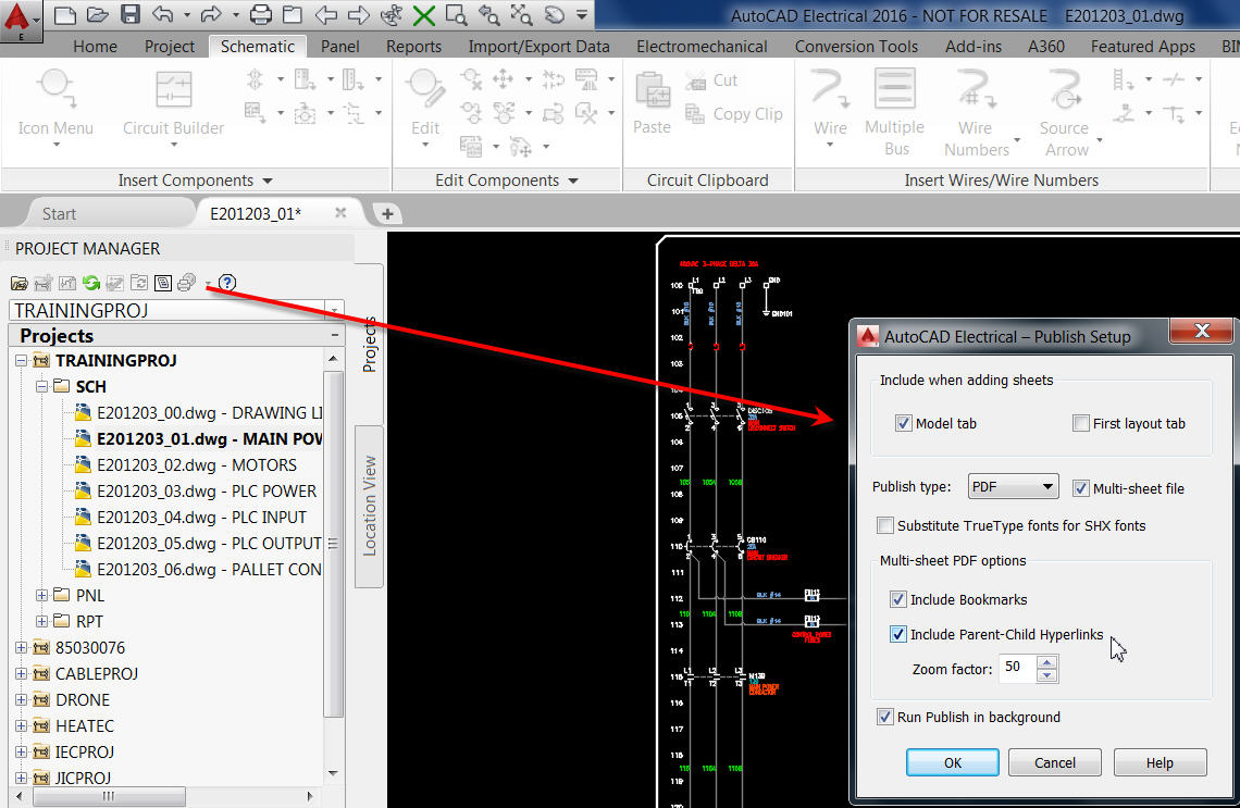

Release 2015 introduced hyperlinked crossreferences.  Of course 2016 includes the option as well.  When you publish the project, select the option to publish as PDF/DWF/DWFx (see screen capture 1).  Next select the drawings to include in the PDF.  Finally, be sure that the option is selected that reads "Include Parent-Child Hyperlinks" (see screen capture 2).

When you publish your project to PDF be sure to select AcadE to PDF.  Also make sure that the option to create hyperlinks is selected.
