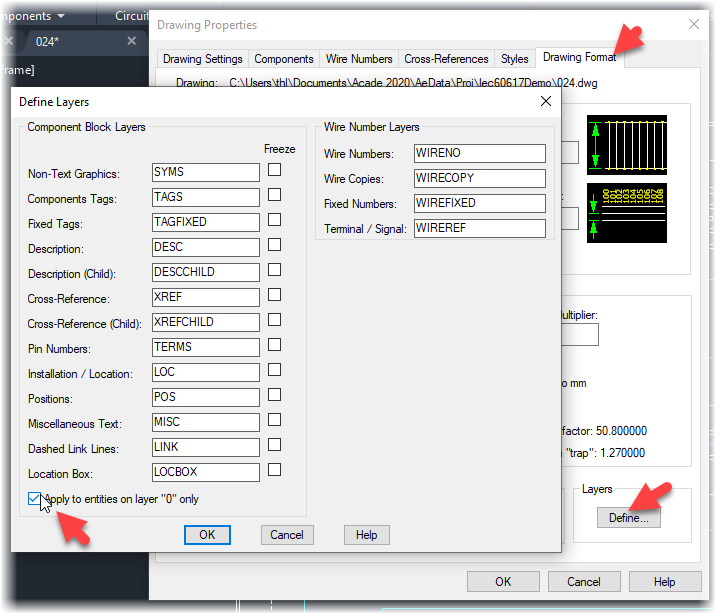

Solution 2
Go to your Project Properties and the Drawing Format tab.
Click on the Layers button down near the bottom right.
Make sure the tick box is selected to make sure that ONLY entities on Layer "0" get moved to the listed layers.
Click OK twice to exit.
Select ALL the dwgs in your project and then RIGHT CLICK to bring up the menu.
On the menu, hove over Properties and then select Apply Project Settings when the sub menu pops up.
Edit the required blocks and move the TERMDESC attribute to a new specific layer with everything else on Layer "0".
Do a project wide update of the blocks. This will create the layer using the last used layer settings in each dwg.
Now it should be simple to write a LISP to go through the project and turn that layer ON or OFF, Hide them from printing and so on.
Regards Brad

rhesusminus
Yes, you can of course modify the code to do whatever you want.
att.layer = "TAGS"
would move the attribute to layer "TAGS".
If it's just for your custom symbols, put them in the appropriate layer in the symbol.
Then, make sure this checkbox is checked in your projects. Then, AcadE won't move it away from this custom layer.
