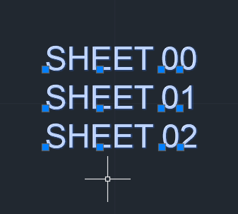

rblack2LEKD
Thanks for the replies, I will elaborate on why I want to have the sheet number in more than one attribute.
I'm using X-Y grid referencing, and have letter along the top, and numbers along the side. I want the numbers on the side to have the following format (this is for sheet # 20)
02000, 02001, 02002, 02003, and so on...
020 is the sheet number and the next two digits are the line number
How do I build this into my template so that when I add a new or renumber sheets the vertical reference numbers on the left side of the page automatically update to reflect the new sheet number?
What I am trying to do is make each one an attribute, have the sheet number as the first portion and then the line number be a constant (00, 01, 02...).
What is the way to achieve this?
Thanks!

Well there might be a more complicated way of doing it, but I would still copy and past the Sheet# attribute in each of those locations. Then put the other #'s close up to them so they flow well.
For instance,  Sheet# attribute (020) then the count as text, would be like so...
Sheet#00
Sheet#01
Sheet#02
Message 6 of 8
Something like this (left text as attribute right text as just normal text). But you'll have to play around will how close together the lift and right text will need to be in order to look nice.
Message 7 of 8

Yes this works, thanks!
I understand the cross reference can have the page number added into it, but I like to see the vertical row identifiers with the page number as well.
