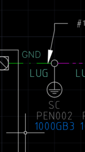

Now, for ground bars, I did it a bit different.
I did these as Parent/Child Groups. Each termination in the bar gets a unique terminal number and them I added the termination in the catalog.
Parent
Child
The Parent is Terminal Lug and then all children get inserted as 1-#. This keeps track of how many connections I have made.
This has been working pretty well for me.
