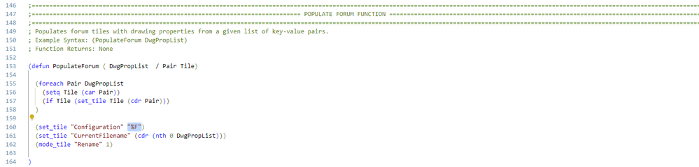

Message 19 of 20
luke_cope
This worked very well. Only issue was it displayed the screen for every drawing. Also any way to change from default %F so I can make it default to what I want?
Message 20 of 20
arshdeepsingh404
Yes, change Line 160 for setting the default configuration field value.
"Only issue was it displayed the screen for every drawing."
This is because the sheet and drawing numbers are stored in the "WD_M" block on existing drawings, so I do have to open every drawing to read its local attributes.
