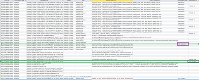

Hello again, I have a problem when extracting the list of material in what refers to PLC devices that have multiple list of materials and that are distributed in two drawings (PLC split into two drawings) duplicates the multiple material, as you can see in the attachment, there are two 6ES7193-6BP00-0DA0, one in quantity and one in SUB. I hope I explained it well

rhesusminus
It's hard to see from the images, but it's the tag PLCIO on one sheet, and PL on the other sheet? That would make 2 devices, i.e. two parts in the BOM.

alex.perezMSQ4H
The only place where I enter it is the multiple material list (sheet 7), and the following drawing is updated (sheet 😎 and that is why I get two, one per drawing, but I don't understand why, because it really is a single PLC component split into two drawings.

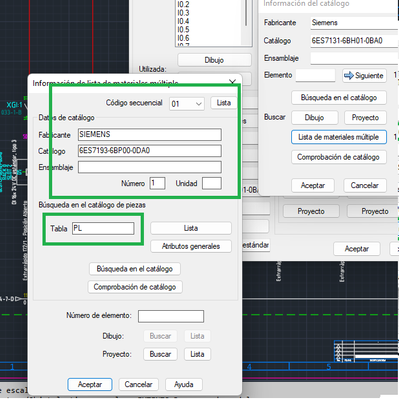

alex.perezMSQ4H
hi, thanks for helping. yes, I have used parent/child especially for coils and contacts. But it seems that PLCs work in another way. I attach the component edition of the second part of the PLC that is in another drawing, as you can see I cannot edit the catalog (as if it were the child) of the main component (parents) but when extracting the list of materials, I duplicates the multiple material not the main material, can it be a bug? if so, is there any way to contact autodesk so that they can store it in future updates?

rhesusminus
While it doesn't seem like PLC's have a parent/child relation, they actually do.
The parent has the TAG1 attribute, while the child has the TAG2 attribute.
Any chance you can share the DWG's with the PLC's so we could have a quick look?

rhesusminus
There are catalog data saved in the xdata of the second half of the PLC.
Use the AEXDATA command and delete all attributes that ends with "01"

alex.perezMSQ4H
Thank you very much, that solves the problem, but I think that extended data is created automatically. that when creating a plc in two drawings does not create that extended data? is it possible to create the plc again without that data?
