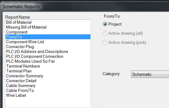

Could you tell us what " elecdes" ?  Is that AutoCAD Electrical?
If you are sub customer, you could find Eaton content pack for ACE2018  at autodesk account.
You could run From/To report.
