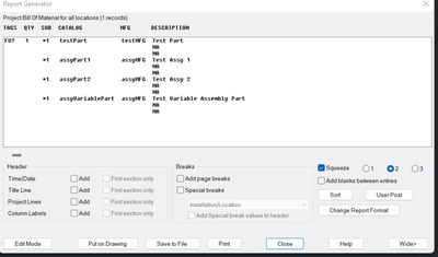

jschierenbeck
We are using SQL for our database, but this can be replicated. The way you shown will work since you are individually listing each part under the assembly code. But if you group them together it doesnt work.
For exmaple,
I added these parts to the database
All parts show up when doing a "Catalog Check"
Parts do not show up when running a BOM in "Tallied Purchase List Format"
If I do a BOM in any other format, the parts do show up.
To add onto the confusion, if I only add one part under the assembly code, it works.
rhesusminus
I can replicate this, and. I consider this one of many bugs.
