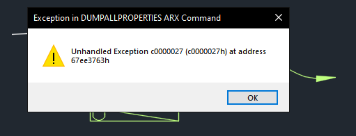

I was learning AutoLISP and I found that (dumpallproperties (entsel)) can drop properties for AutoCAD objects.
Is there any equivalent for AutoCAD Architecture Objects? I tried again dumpallproperties but is incomplete, for example do not show object style name.

Also using dumpallproperties drop error:
