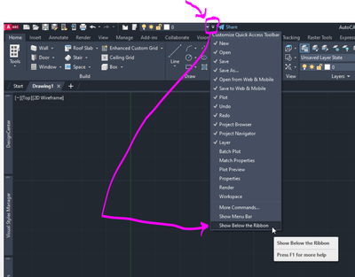

The RIBBON customization is we defined, but it's not going to look like what you sketched out.
Are you just wanting to create a row of button to click on to insert your custom content? Then move the QAT from above to below the Ribbon
Then create your desired -INSERT command macros or LISP as "new commands" in CUI's section here
Then drag-and-drop them to the QAT like this
There should be enough space for 100-ish button if that is all you need.
Any reason you're not interested in simpler solutions like Toolpalettes or the classic ADCENTER command?
