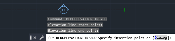

If I use the BUILDINGELEVATIONLINEADD command, I am asked for start and endpoints of the elevation line (ACA appears to choose a depth based on what is in the drawing in the direction the elevation looks), then asks for an insertion point for the generated elevation (in this drawing).  There is a Dialog option, which allows you to specify the settings for the elevation to be generated.
