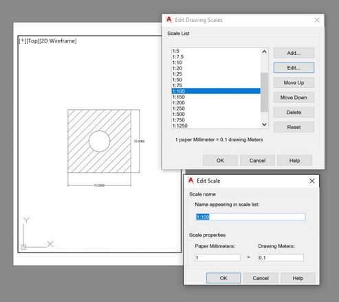

Hello
I know this problem must have been asked a million times, but I have never in 8 years of Autocad use found a definitive answer for my constant problem.
In model space, I always work in Meters, 1:1 scale.
So, 1 unit = 1000mm
Then in Paperspace I want to scale drawing to 1:100
(so, 1m becomes 1cm, or 1000mm = 10mm)
See below, snapshots of my settings.
I go to Paperspace, A4 size (21,0×29,7cm), select 1:100 scale and the drawing makes a huuuuge zoom, so I can't see nothing. (default scale values)
The example given I made a 15m square, that is supposed to be 15cm square on Paperspace with 1:100 scale, and appear completely on the sheet. It disappears once I set the scale. Frustrating, I've wasted hooours with this, multiple times, just trying thoughtless methods on trial and error.
I need a consisted method, that always works and is saved forever that everytime I open any Autocad (with my login to autodesk) remembers that I want these settings, specially not with interfering imperial units, which is also another bothersome problem.
I've then tried editing the scale values (sometimes I can, sometimes I can't, it's greyed out). And I input the following, that worked.
1 paper Millimeter = 100 drawing Meters
But it makes no sense, because 100 meters is not 1 millimeter in 1:100 scale.
And then I would have to change all scales (1:50, 1:200, 1:500 etc..) individually for them to work as supposed, which also is not sustainable if I have to work like this.
Please Help!

When plotting paperspace, if you want to plot to scale, always choose 1:1 in the page setup.  Then you use the viewport scaling features to scale model space views. As far as paper sizes go, in page setup, use 1 mm = 1 paper space unit, since the paper and titleblock size for metric sheets is in millimeters.
If you don't want to plot to scale, choose anything but layout to plot in page setup and then choose fit to paper.
Note, when viewing paper space, while not in a viewport, note that the annotation scale disappears.  Hint: This is because paper space should always be plotted a full scale in order to scale viewports properly.

"use 1 mm = 1 paper space unit, since the paper and titleblock size for metric sheets is in millimeters"
So this was the problem! It makes more sense now but still confusing system.
In the studio I work at, page setup scales are set to 1000mm = 1 unit, and things just work out. Don't know why in my personal autocad version i must use other values.
