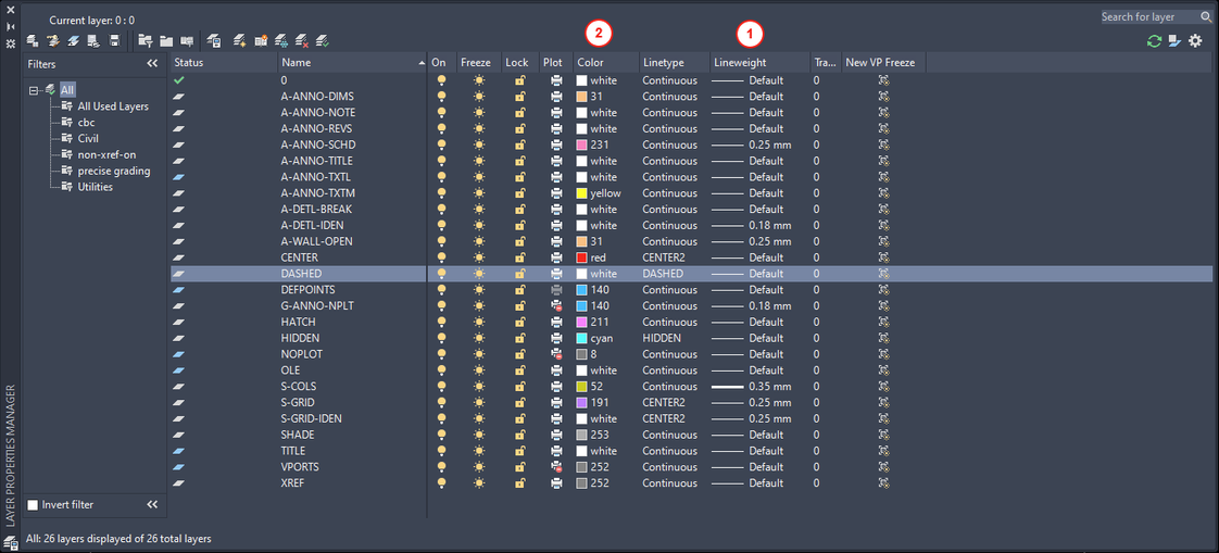

R_Tweed
It would be more helpful if you posted a sample pdf to see how it is organized (layers etc).. Also, you should be making two pdfs.
1. vector linework
2. shadows only.
The vector linework can be converted through the import function.  Once the linework is imported, you can assign layers and control your linweights through the layer palette. Lineweights can be controlled by either linweight property (1), color (2) or a combination of both.
This will depend on whether you opt for the stb or ctb.
I do not recommend this method, however, lineweights can also be applied to individual objects using the property palette.

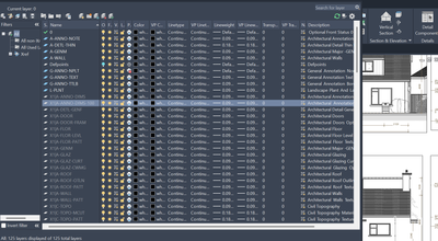

R_Tweed
Your layer palette will look less cluttered if you work from model space.
Make sure you do not have object overrides. Object properties would be bylayer as shown below.
Post a screen shot of your plotting parameters for output. the sample below is based on a ctb plot style.
