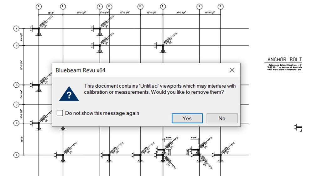

Thanks for taking the time to help. You were right about the bluebeam message.
In summary:
The problem:
In AutoCAD For the layout1 tab: In Page Setup, I was selecting custom -> 1" = 1 unit, or I was selecting 1'-0" = 1'-0". Both should have made the PDF page scale 1:1. My viewport in layout1 was scaled to 1/8"  = 1'-0". I would then plot this as a PDF. However when I opened this new PDF in Bluebeam a message would pop upfixed.jpg
and I would click no. Then when I went to bring this PDF into AutoCAD using PDFIMPORT, the PDF scale would say 1/8" = 1'-0" when I needed it to be 1:1 so I could demonstrate scale factors to someone.
The Solution:
When the message on Bluebeam pops up I clicked yes to remove the untitled viewports. Then I saved the PDF. Now when I go to bring this PDF into AutoCAD via PDFIMPORT it says the PDF scale is 1:1.
