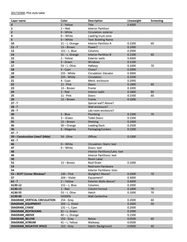

Image 5: Additional, but not critical, question: is there a preset translation of the 63 Microstation layers into AutoCAD? I've also spent some time looking for this, to no avail. You can see I've attached what I think each layer corresponds to, but some I am clueless about.
