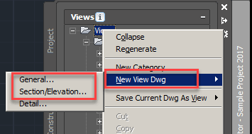

3d model and light 2D section/elevation can be divided by selecting type Section/Elevation >>
see the difference >>  General >>
