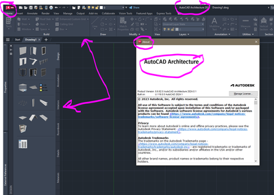

That can mean two things:
1) they did not actually install AutoCAD ARCHITECTURE 2024, just AutoCAD. Ask them to send you the program's ABOUT command pop-up s a screenshot. It should look like this
2) They are running ARCHITECURE "as AutoCAD", nd they need to activate the correct profile in OPTIONS command's PROFILE first instead of the "autocad" profile
Shaye_Clements
The profile was set to AutoCAD, so changing it to Imperial fixed the AEC issue. Thanks again for your help.
