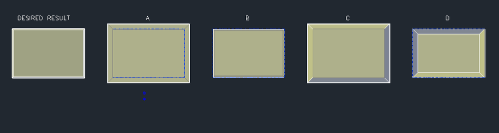

I believe I am almost there but I can't quite get the desired result I am after so I have attached the CAD file, maybe someone could tinker with the edges to show me how to do this?
Shown is:
The desired result with a non editable 3D solid, fit the purpose but no good for re-use
A,B,C,D are all dynamic slabs with edges modified but non give the desired result!
David_W_Koch
The attached file gives you the desired result, but perhaps not all of the functionality that you are expecting.
The fascia Profile polyline has to include the full depth of the Slab.  You can have it auto-adjust the height to the edge height (measured perpedicular between the top and bottom faces of the Slab), but that will scale the entire profile, not just the height, so I left it turned off in the Slab Edge Style I created.  To maintain a 25x25 bevel, you will need a separate Profile and a separate Slab Edge Style for each slab thickness.
The insertion point for the Profile should be at the top, inside corner, as noted in the attached file.  I gave the Slab Egdes a -25 offset so that the Slab defining line is at the face of the Slab Edge.  You may prefer a different arrangement.

Thanks David and Vstudley,
This is good enough for me!
