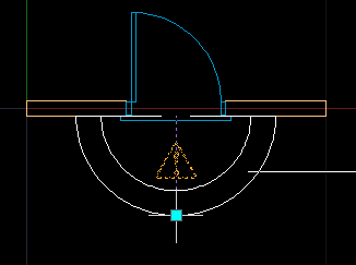

Does anyone know how to create curved semi-circle stairs like the attached image?

Good question... I tried the apply to linework tool and this is what I got:
Doesn't seem to accept stringer paths that meet. I would suggest using 3d solids or mass elements to represent what you want to see.

Here's one way to do it.  I gave up trying end up with a decent stair path.  I left the linework in the file so you could see what I did.  I made sure to let it end with a tread.  BTW lots of fatal errors trying to get to this point.

Finally got it to work... Created two stair tread polylines and stair path. Used apply stair tool properties to linework -> select Treadprofile option and select the linework. Modify the properties to end with landing. No errors along the way. Here's the pic and file (ACA 2012).

All beeee!  That's great.  I always thought that creating staircases by linework required stringer lines on both side of the stair case as well as a single line at each riser, whereas you outlined the treadprofile.  That worked flawlessly.

Yeah, I banged my head against the stringer path issue too, first reply was the result. ACA doesn't like it when the stringer paths are coplanar. After a good nights sleep I tried the treadprofile method.
