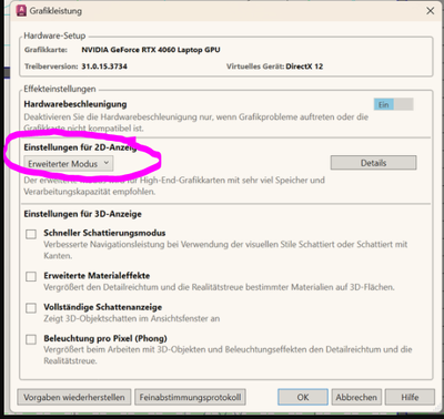

Hello everyone, I got my student version of AutoCAD Architecture today. It works fine except that i have a black bar flikcering at the bottom and it's driving me crazy...
I attached a pic of where the black bar always pops up.
I have found this problem on the AutoDesk website but all tips didn't heltp.
I also reinstalled it and it still is the same...
Thansk for helping

So I found out if I turn off the Hardware boost it doesnt happen anymore. But the AutoCAD looks bad. I hope there is a different solution. I mean I didnt buy a expensive laptop to have to put AutoCAD in to low grafik settings...
Do you have this update installed yet?
If not, get it from your Autodesk Account Page here https://manage.autodesk.com/cep/#products-services/updates
Restart your PC afterwards.
If that did not help... Set GFXDX12 variable to 0 (that's a zero) then restart AutoCADARCH2024: reverting to DirectX11 fixes similar problems for most users.
If still no relief then start GRAPHICSCONFIG command and change the 2D Display Settings pulldown from "advanced mode" to one of the other choices
If all else fails, then turn off Hardware Acceleration as a last resort, and start a support ticket through your subscription portal as explained here
https://www.autodesk.com/support/technical/article/caas/sfdcarticles/sfdcarticles/How-to-find-my-sup...
Message 11 of 11
daniel_stebbing98
Thank you so much! Downlaoding the updates made the black bar stay there but not flicker any more and after setting it to directx11 it is completely gone!
