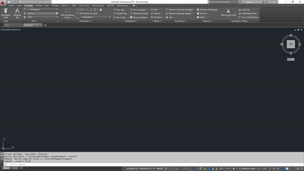

I've never encountered this before.  Tried everything I can find online and nothing mimics the issue I have and fixes it.
Pickadd: 2
Pickfirst: 1
qaflags: 0
Right Click Customization is on
When I select an object (it highlights in blue w/grips) then I right click and choose "select similar" and instead of selecting all similar objects (as it's always done) it now deselects the object I previously selected, my crosshairs turn into a pickbox, and the command AECSelectSimilar shows up in command line and asks me to use the pickbox (square) and says select objects.
When I select an object it is highlighted in blue (no grips) after you select the object you are just left sitting there doing nothing with no direction forward.
Typing in the selectsimilar command produces the same effect, nothing.
This is cumbersome, time consuming and frustrating, to say the least.  Help?!
Only thing that happened before this started .. I upgraded from Windows 7 to Windows 10 2 weeks ago, and this just started this week.  It worked fine (as it always has) the week previous.
I have rebooted several times, nothing helps.  It does this in all drawings.

I don't think my last graphic recorded correctly (new converter I had to use) maybe this will work right lol
Basically what I have to do to select multiples is
select object
right click, choose select similar from menu
the pick box appears, then I touch an object (basically this cancels out selecting it previously)
then hit enter
then click the object again and it will then select all that are similar .. so annoying!
