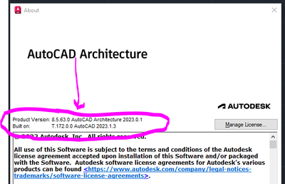

dtobin88
I am using an HP T2530 plotter/scanner. We have used this plotter for several years and had no issues with paper sizes.  I tried for several hours and finally decided to install ACA 2023. Using the exact same steps I have used for all previous versions of ACA and the same ones I tried in 2024, I was able, on the first attempt to create page setups for E1 and D size sheets and they both printed correctly. This tells me there is a bug in the plot code of the 2024 program that is not working properly.

I am having the same issue in ACA 2023 with the pdf settings.  I had page setups for D and E1 size sheets and this version won't accept those.  I have tried recreating them in 2023, but something ois sticking where even though all settings say landscape, no matter what I do, after going through custom properties, when I get back to the main plot screen the paper size reverts back to letter or presentation board.  When I change it back to E1, it always rotates back to portrait.  It's like ACA is defining E1 as portait and nothing will change this.  I am trying to use the Adobe PDF printer but I have also tried the Bluebeam PDF printer.  Both printers force E1 to portrait no matter the settings I choose.
