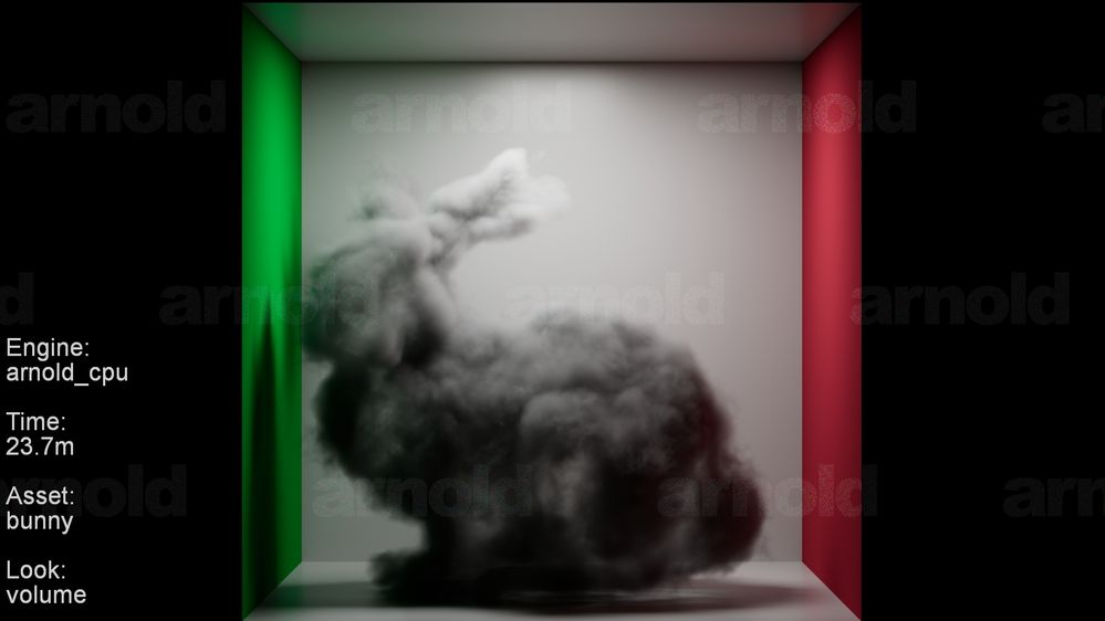

Good day,
I'm running a render test on a volume between Arnold CPU and GPU.
The render test is the VDB "Bunny" asset with a simple volume shader.
While the CPU rendered the frame in 24 mins, after 1 hour+ of waiting the GPU render was only on around 11%
CPU:
Sampling: Min AA 3, Max AA 12, Threshold 0.001
Depth: 3 Spec, 3 Diffuse, 3 Volume
Render time: 24mins
GPU:
Sampling: Min AA 10, Max AA 26, Threshold 0.001
Render time: 1 hour+ render wasn't completed, only at around 11% (canceled the render test)
The reason for the increased Min AA is to prevent zero pixel values.
I lowered the sampling settings to try get a frame out.
GPU with lowered Settings:
Render time:  64mins
  1. I'm getting double the expected render time, even with lower sampling settings.
  2. We're also seeing what appears to be shadow artifacting under the volume.
Are volumes not very optimized for the Arnold GPU engine yet?

Message 2 of 9
am_wilkins
Hi there, I did some additional testing.
I've managed to bring down the render time of the CPU Adaptive, however the GPU engine is still taking very long and the shadow artifact remains. Even with a higher adaptive threshold (tried all sorts of combinations) and the result is significantly more noisy.
I also reduced the "Density" of the shader (was a little too dense in the previous post)
I'm looking to:
1) Reduce Arnold GPU render times while still achieving a clean result
2) Solve the shadow artifact
CPU:
Sampling: Min=3, Max=12, Threshold=0.01
Depth: 3 Diffuse, 3 Spec, 3 Volume
Volume Step Size 0.1
Volume samples on light - 2 (default)
GPU:
Sampling: Min=3, Max=14, Threshold=0.05
If you download and compare the images, the GPU render would need higher AA samples by almost double (or some lower threshold) to match the CPU render and then we'd be looking at 1 hour+ render times again.
And then, sorry to do this (hurts me too) but here's a Redshift comparison which I'm trying to compete with.
It appears like I have no chance of getting close to this render time with Arnold volume rendering.

Unfortunately, GPU volumes in Arnold are known to be slower than we'd like, so I'm not surprised, especially with your CPU, that CPU is faster than GPU. The artifact is likely one we are already aware of and is tracked in ARNOLD-13469. Both the artifact and performance we want to improve.

Hi, the just released Arnold core 7.4.3.0 and associated plugins have improved gpu volume performance. Our release notes show 2-3x speedups for volumes like those in this post.
How is 7.4.3.0 performing for your gpu volume scenes?
As for the artifact you reported, I don't believe that has yet been fixed.

We updated version to Arnold 7.4.3.0, I opened the old test scene from this original post and ran a render test again.
The previous tests were done on the A4000 GPU.
R 41| 00:00:00   462MB         | there are 1 light and 5 objects:

x1 RTX A4000 (NVIDIA driver version 575.51)
Appears to be about a 18min rendertime difference per frame compared to the previous. (+-180% speedup)
I'm not sure if the Nvidia drivers would impact this, but I'm working on getting this machine updated.

x1 RTX 4090 (NVIDIA driver version 576.80)
Not previously tested with.
1m 46s on Arnold 7.4.3.0 previously 3m 46s (136% speedup) on the version before.

As a bonus, 6min 26s on x2 A4000 GPU.

Quite a big improvement, thank you!
I also see that the shadow glitch/issue is now fixed.
It's worth noting that the render quality is still quite noisy at these settings and would need some extra samples or perhaps denoising to work on production, I will try some higher samples next to see how easily it can clean up at the expensive of higher render times.
