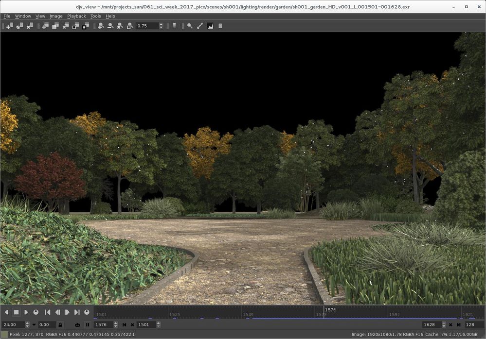

I have white spot on my render images, How I can remove them? I found solution on https://support.solidangle.com/display/A5AFMUG/Fireflies+-+Boat+Scene but not help.
8,723 Views
The problem solve after I remove distant_light from a scenes But How I can keep distant_light on my scenes and remove white spot.
