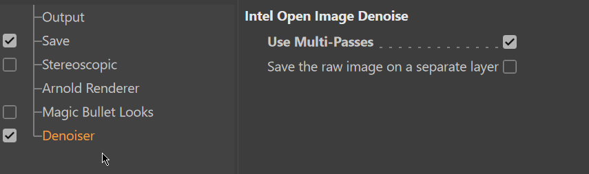

C4D denoiser works after GPU rendering but with CPU rendering (nothing is changed on the scene) after render process is done denoiser doe not work. Is there any idea about that?
(C4D and Arnold latest versions on Windows 10 - 1080 TI Card)

Hi Peter,

Ah, ok, I've never tested that, since we have our own denoisers in Arnold. I'm not sure how the native denoiser works. The only difference I see between GPU and CPU is that GPU renders the frame progressively, otherwise they produce the same final frame buffer, so not sure why it does not work properly on the CPU. I recommend using the optix denoiser instead, go to the AOVs tab in the Render Settings, select the beauty and check 'Denoise (OptiX)'. The result is saved to a separate layer, called 'beauty_denoised'.

For the C4D Denoiser (really, the Intel Open Image Denoiser) to work, you need to set "Default filter.Width" to 1 (from 2) in the Arnold Render settings. You may also find that the effect varies a little depending upon whether you have the "Default filter.Type" to Gaussian or Sinc or whatever.

Just like the OptiX denoiser in Arnold, the C4D Denoiser works best with the box filter. That's the difference between the GPU and CPU render. GPU render always uses the box filter, while the CPU render uses the filter from the render settings, which is gaussian by default.
