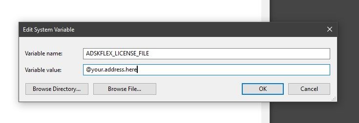

You'll have to add the system variable to the machine that wants to connect to the license server... in my case, it's running on a Mac mini on the LAN and this is what my Windows machines look like that tap into it:
Once I do that, any machine I'm working on can access the license server and depending on how many seats you purchased, you can use Arnold on up to that many machines at once... every time Arnold is triggered in C4D, it will check the license server to see if any seats are left... if there are, it will check one out and you won't get the watermark

Eden_Soto1
Shawn... just hit the Windows key and start typing "environmental variables" like so:
Then once you're in that control panel, click here:
Then in the bottom section, click "New..."
Then fill it out like the image above, typing "ADSKFLEX_LICENSE_FILE" for the Variable and then whatever the address of the machine running the license server on your network is starting with an "@" symbol... can be an IP address or (like mine) a DNS name... would look like this:
Then click "OK"... best to either log out of the current user or restart your machine after that just to make sure it's registering.
After that, you should have no troubles using Arnold on the Windows machine.
Hope that helps

I finally got a chance to install Arnold on this PC. I followed the instructions above, and, miraculously, it worked! I'm still not 100% clear on HOW this works, but the upshot was I was able to render a scene on the PC twice as fast than my MacPro would have been able to do, saving 8+ hours of render time.
Thanks again for the directions!
