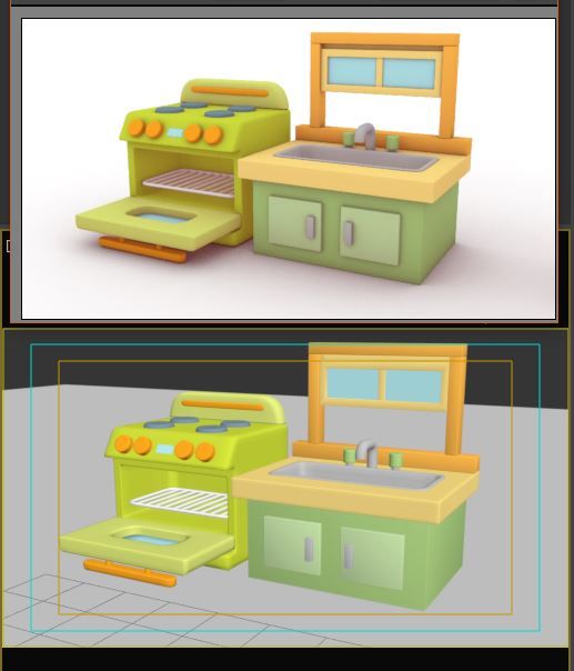

6007-viewport-and-render.jpgThank you for the reply.
I had tried the OSL color node before, but it did not show in the viewport. Since you mentioned that OSLs work in the viewport I looked at it again and found out that it doesn't work on Arnold Map to Material. It does show in the material preview but doesn't work in the viewport.
In our workflow our materials are very simple, basically multiplying a flat color with ambien occlusion through Map to Material. Being able to see the color in the viewport is high priority for previewing animations.
Will OSL maps work with Map to Material in the future?
