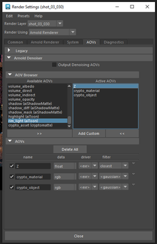

so I am experiencing issues with my Maya scene when my rendered multi-layer EXR sequence has incorrect/ broken Cryptomatte and Z depth passes.
CRYPTOMATTE  issue:
- they are set up from AOVs, nothing changed to its default settings (like this in the past it worked without issues)
- rendered with Render Sequence, its multiLayer EXR with Merge AOVs checked

I don't remember seeing any issues like that. Do you have repro scene you can share?
Is there anything in the log? What else is in the scene (imagers, operators, ...) ?
If you render just Z, or just cryptomatte, are the both still broken?

thanks for the reply. The scene is actually quite heavy to share, but perhaps I can try to reduce it to a minimal area. No it doesnt contains any imagers or anything like that
EDIT: but what I do have in the scene is quite a few alembic caches of animated characters
EDIT 2: I solved the Zdepth issue - it was read node's color space that caused the Z pass to go flat. Due to ACES workflow I was swtiching read nodes from Scene Linear to Output sRGB to match the look of my Arnold Render's view, but it doesnt solve the cryptomatte issue
EDIT3: removing Z and N AOVs to keep just cryptomattes as you suggested ddint help either

Hye, so after investigating further it seems like both issues were caused by color spaces, more precisely wrong output transform that was impacting Z and Cryptomatte passes. It all seems to work now
osukas
just adding because this problem happens to my coworkers
when they use the node REFORMAT in Nuke, the cryptomatte gets detroyed. You need to create your mask first with crypto, and then use reformat. We do this way because of time constraint we rendered in 3k and reformated the render to 4k
