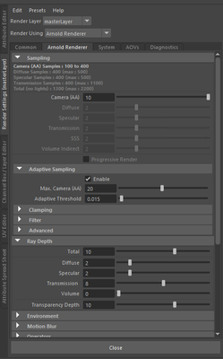

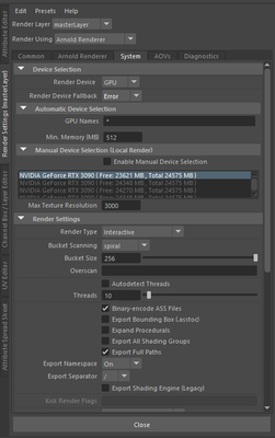

Well, it's a GPU render. it looks great as a CPU render. but I'm paying for a GPU render service and it looks great on another project. here are some settings.

Stephen.Blair
16 AA samples for Arnold GPU is not really a lot, unless you're using adapative. In which case, that could be too high.
Did you try increasing Max Camera AA?
Matching Noise on CPU and GPU
Matching noise can take a little experimentation because Arnold GPU uses Camera (AA) sampling only. We recommend you also use Adaptive sampling. Here are some guidelines:
  • Set the Max. Camera (AA) in the range of 30 to 50 (depending on the scene, you might go closer to 100). In general, the max samples should be a large value. A large max samples means that the quality is controlled by the noise falling under the threshold, instead of by clamping to the max AA.
  • Set the Adaptive Threshold to something like 0.015 or 0.02. For a noise-free render, lower the threshold value, maybe even as far as 0.010.
  • Set the Camera (AA) samples to around 3 or 4. One of the few reasons to go higher with AA is for motion blur. The higher the number of Camera (AA) samples, the less of a speedup you'll get from adaptive sampling.
// Stephen Blair

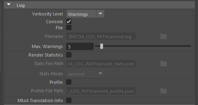

Where do I find the render log files?
Is this it?

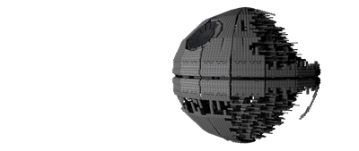

Sorry, I forgot to send the render, this is at the setting you recommended 5AA 3 light samples. this was an .exr file but I had to convert it to png to send it..
TwigaArts
I think the Adaptive sampling was it I'm going to give it a try in I render! Thank you both I learned so much!
