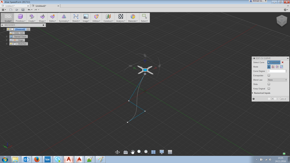

Can't really tell what could cause the snapping issue for you? See the following image, if I activate grid snapping, the Curve CV creation automatically snaps to grid points when you are close enough, no additional key needed (ctrl can be used to temporarily deactivate snapping):
Also when editing the CVs of the curve, the snaps works for me:
On which Speedform version are you?
And I still don't really get your vertex problem. Do you know the basics of subd modeling? There are several ways to display your model. Create an object, e.g. a box, select it then to start Edit Form, and press 1 for displaying it in box mode, 2 for displaying it in control frame mode (is it this what you are looking for?) and 3 (default) for smooth mode. Does this help?
