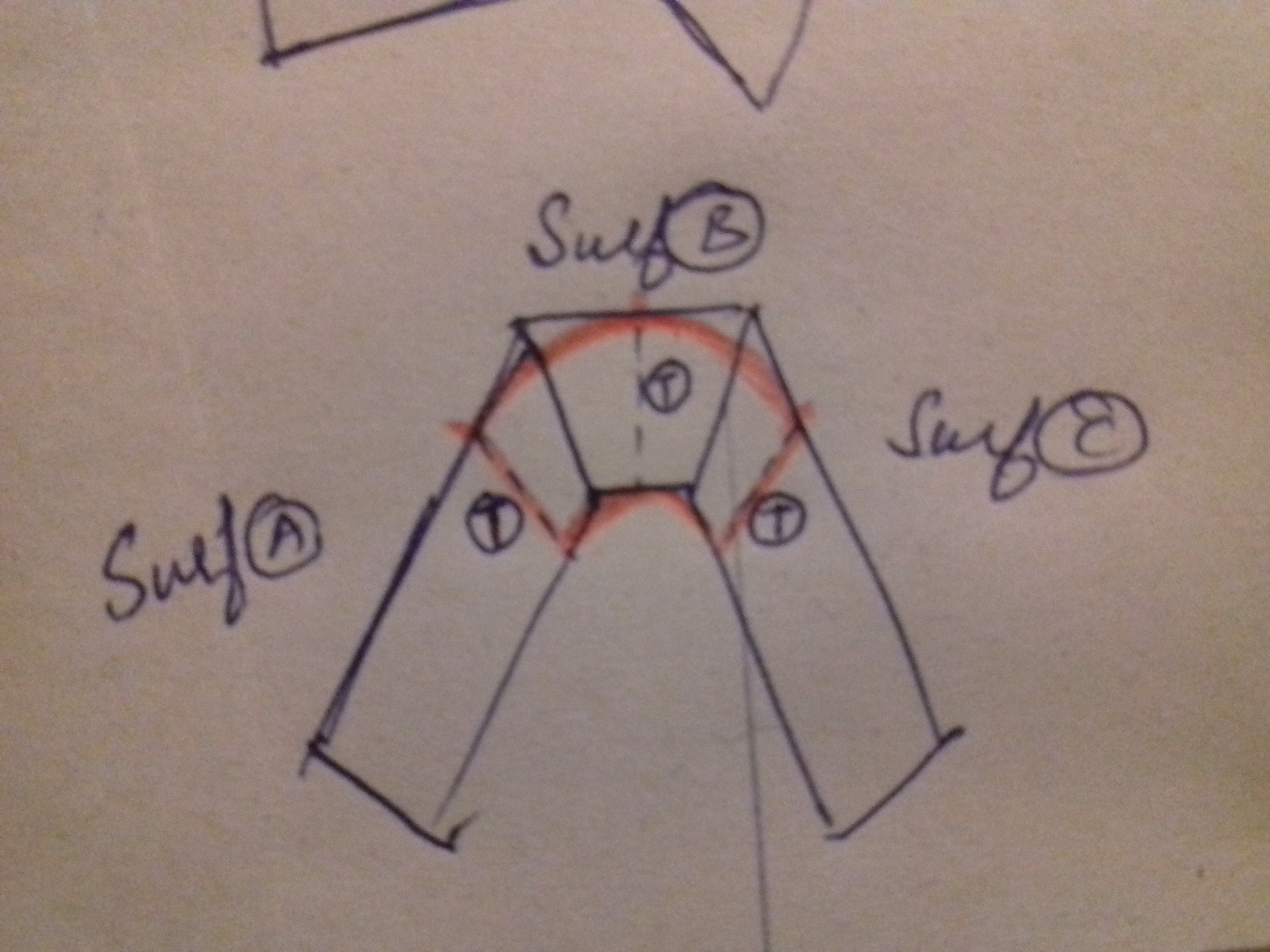

I wanted to build a Circle which is Tangent to 3 Lines. These lines are in a single Plane. The simplest example would be 3 sides of a square.

The situation is not in 2 dimensions as you are thinking. For the sake of simplicity I explained it in 2D.
When I have 3 surfaces which are like the 3 sides of a cube and I want a fillet which is tangent to all surfaces I have to build a curve and then the surface as Alias is not having any command where i can build it directly by selecting the surfaces.

Hi
I can only attach a sketch of my problem.
If I am unable to clarify the situation then we have to wait till Monday.

Now I see that's exactly what you don't want.  If your attached surfaces are flat (as they appear to be in the sketch), I think you'll have to hand build it.  I don't believe there's an automatic way to do this.

If the lines form a square, there is exactly one circle that fits, for each circle can be inscribed into a square; use a circle of the diameter that matches the square's height/width.
If the lines don't form a square, one can solve the algebraic equations or construct it "manually". Draw two lines that bi-sect the angle between two pairs of lines. Where these intersect is the centre of your circle. The radius of the circle is obtained by dropping a perpendicular line from the bisector intersection point as shown.
