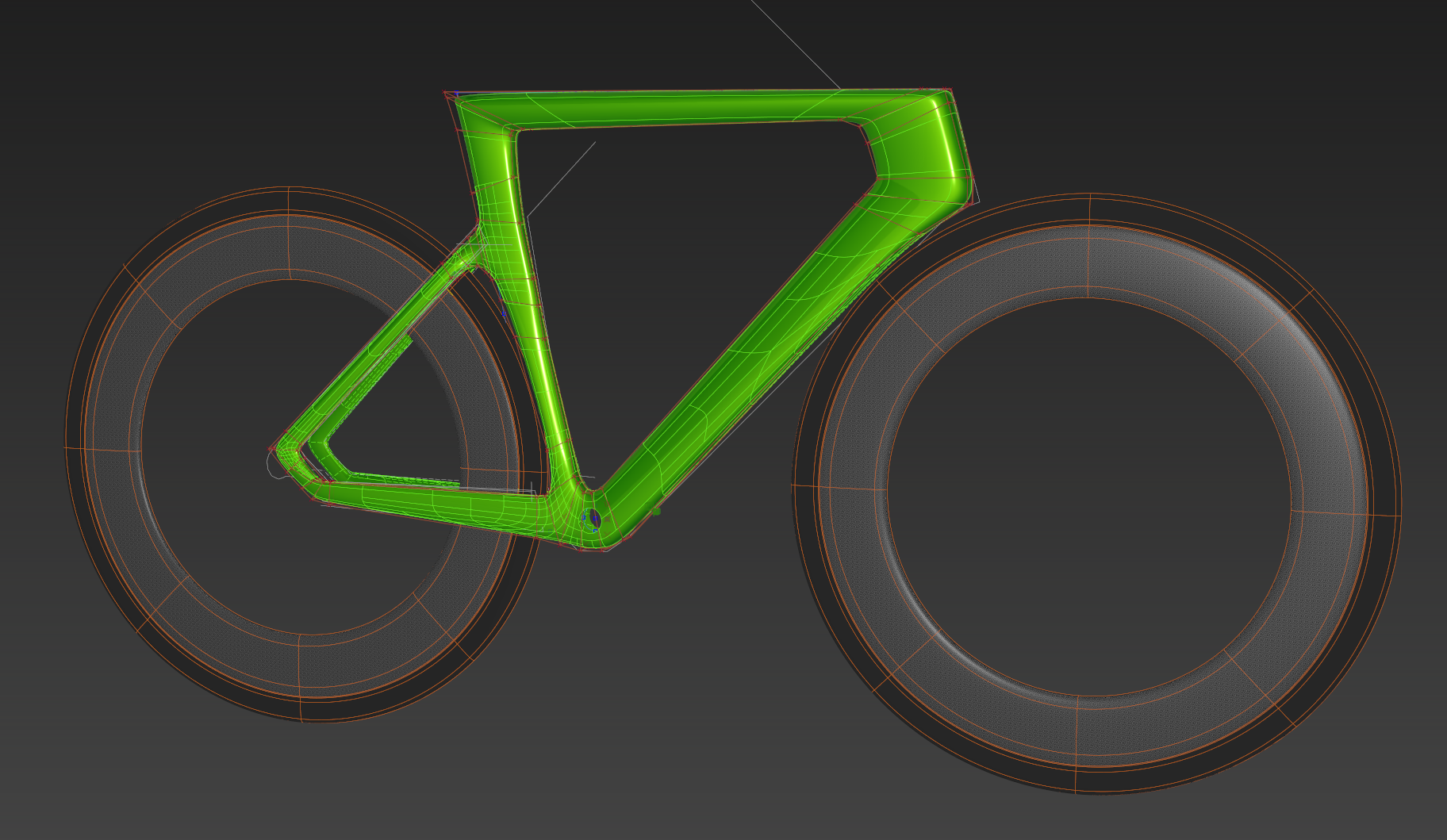

I have tested it now quite a bit, there are limitations I feel need to be improved.
I would rather create a basic shape via Lines and create the surface/Volume by blending between the lines. A little like you would start modelling interior / exterior Models with Maya.
With Alias Solution I more or less have to start with a basic shape (Cylinder, Quader, Surface) and modify, this seems not to correspond to the desire to have control over the shape by precisely add geometry just where you need it.
Did I miss such a possibility in the provided toolset ?

You can use Subdiv Extrude on degree 1 curves

I found out that you can actually use new CV Curve with curve Degree set to 1 in uniform mode will provide almost the same result as in Maya. you can at least extend the result with Sub D Extend.
Works well Though
Message 11 of 20
shinji-pons
Yes any degree 1 curve will work even circles which you can detach to make things like perfect wheel arches
