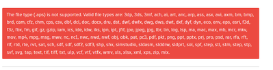

m_emil2004
Hi, apparently the .aps is not supported for this forum.
Please email me, so I can send you the aps file.
Cheers,
Emil.
