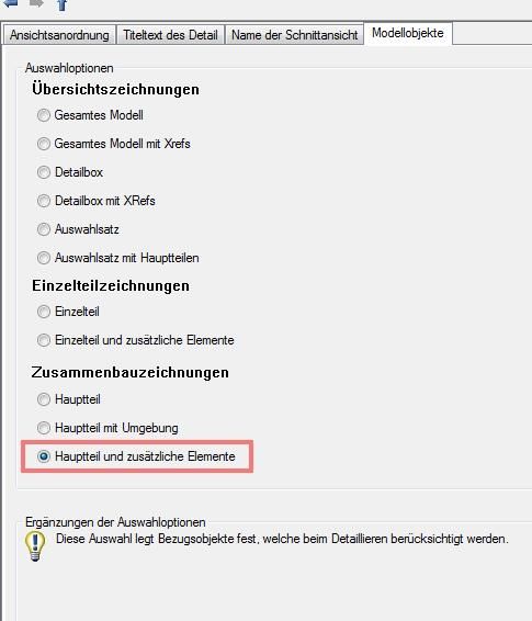

horstbauer6692
At the moment we're trying to do this with "Hauptteil und zusätzliche Teile" (I don't know the english name).
Nevertheless, it would be easier to do this with a process.
My suggestion is to create a process with "Hauptteil und zusätzliche Teile" where all parts with the role "Reused" are automatically chosen by Advance Steel and all at site welded parts. Unfortunately this is not possible at the moment.
