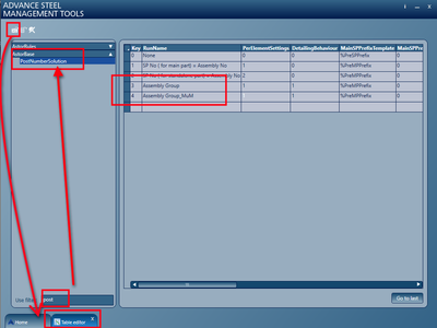

Hi @Dday04
I think this is already possible with the following steps.
  • open the Management Tools and the Tableeditor
  • open the databases and filter for "post"
  • open the table "PostNumberSolution" of the AstorBase and copy the line "Assembly Group":
  • now you could change the SPTemplate to adjust the letter aterwards the MP number:
