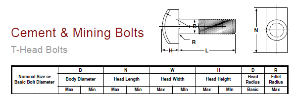

Also add special screws, e.g. T-head-bolts for cement and mining. This bolts are sunken in a thick plate. It would be nice, if this option is also available. PLease note the special hole for it (see pictures below)!
Nicht anwendbar
we need to create also the "thread bar" by selection of one point and all objects that they needs to be onnected.
Currently if I need to insert this object, I need to inser all components as special parts.
