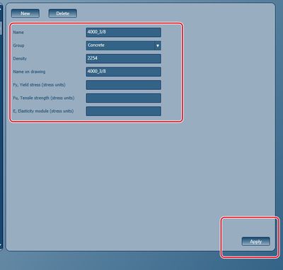

Sebastian_Eiche
first thing to know is: the density is set as metric--kg/m³, so I used a the google search to convert it:
So after this I open the management tools + object property Editor, select an existing material, press new and insert the values:
your post sounds a little bit ironic, so did I miss something? Maybe I mssunderstood the original post?

muleman1
this is what we needed. we understand where to add the new concrete. we just had no idea how the density was measured. now we see kilos in your screenshot. In our AS info it says density of concrete is 1.45. We have tried every conversion Google knows to convert 1.45 weight to the reported pounds in our BOM...to no avail.

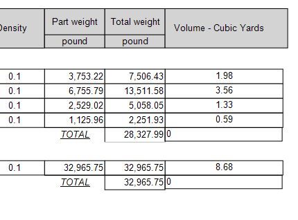

Well I had not set my reporting correct in BOM setting...duh.. It working now, but bad calculation some how....???
The test block of concrete is 3ft x 3ft x 3ft and should weigh (density ??) 3800 pounds (not 105,162,635) and should be 1 cubic yard (not 46,656.01)
....How easy it is to acquire knowledge, yet how difficult and painstaking is the process of gaining wisdom. .... Chuck Swindoll
Message 14 of 26
muleman1
OK !! I figured it out somehow and accidently!! Could not have even attempted without @Sebastian_Eiche and @johnjmbennett   THANKS!
The density factor turned out to be .08145 (whatever that is a factor of, I have no clue, I just know it works) The formula on the BOM for total Cubic yards worked out to be" |GlobalWeight/3800 " 3800 being the weight of a yard of the concrete in discussion. Smiley Very Happy Smiley Very Happy Smiley Very Happy Smiley Very Happy

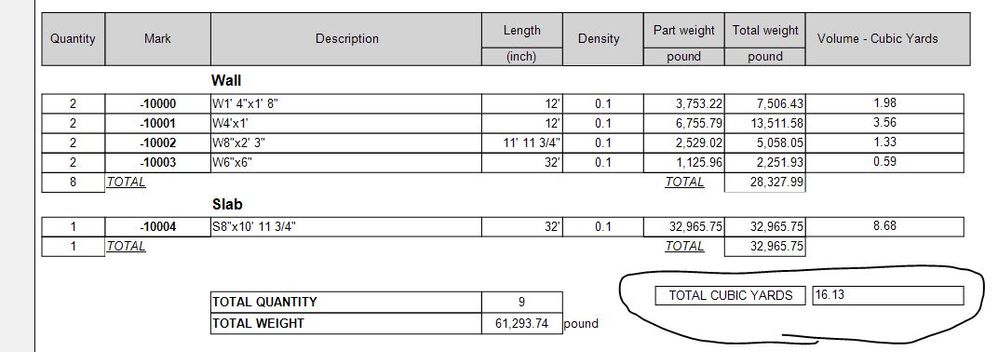

muleman1
@johnjmbennett one last question. I used our new BOM in a model and it worked fine, but did not sub total and/or total our column of cubic yards. What formula or tag or whatchamacallit do you use to subtotal and total?

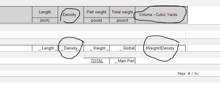

Sebastian_Eiche
the old AKN is not available anymore =(
The problem is, you had to use a little adjustment:
Sebastian Eiche

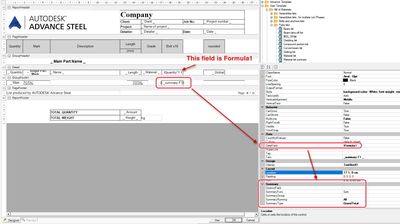

Sebastian_Eiche
you use a formula for creating the request. These formula has a number for example: formula1 or formula5
This number had to be used in the datafield of the field, where you want to summarize your formula. then you have to change the the points I show in the screenshot

muleman1
@Sebastian_Eiche  Got it! Thanks! Now it all works fine.
