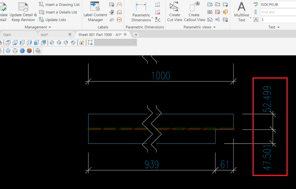

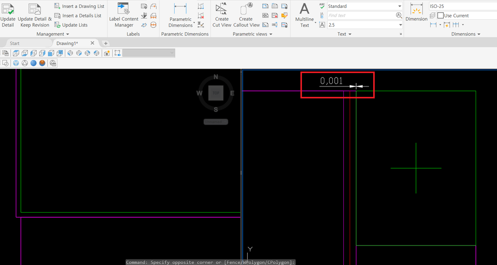

For sensitive detail modeling and drawing in Advance Steel, when I create Rectangluar contour on flange of beam. Contour has 0.001mm gap. This is shown on modeling as well as drawings.
used software: Advance Steel version: 2021, International country setting.
Is it bug or possible to control setting in default?

This gap is not a bug, years ago we get the response from the development, that this minimal gap is  needed.
For some calculation a division by "zero" is not possible, so the some settings in Advance Steel are set to 0,0001mm. But this should not really have an influence in steel construction
