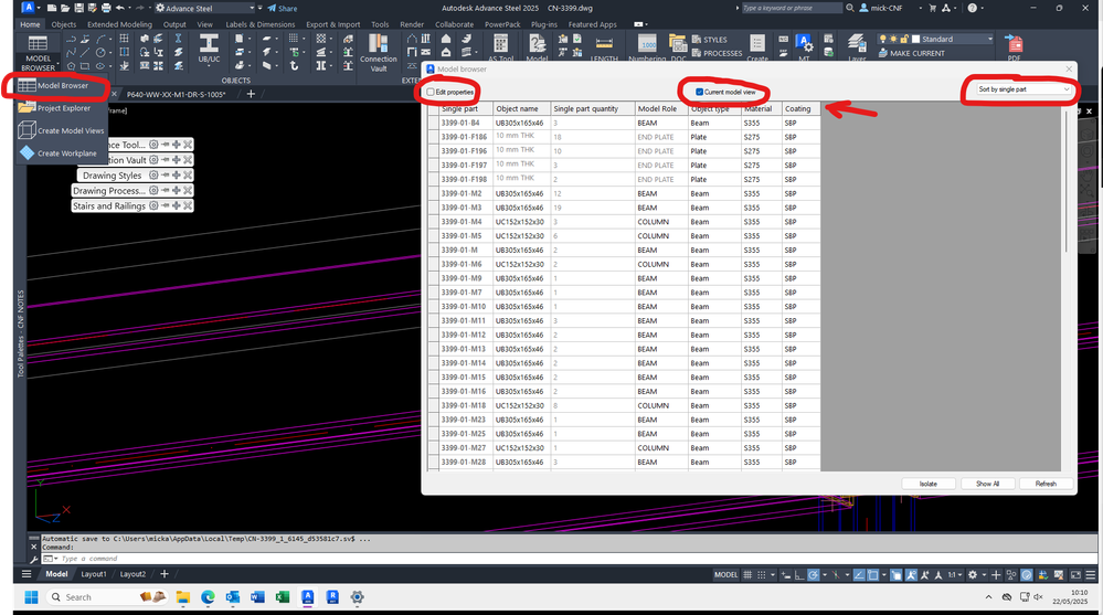

mick-CNF
The model browser is pretty good for displaying information.
You can add and remove the columns at the top to suit, edit some properties, display full model or only items visible, select multiple items by single part or assembly to isolate and so on.
If this information solves your problem please accept as a solution.
