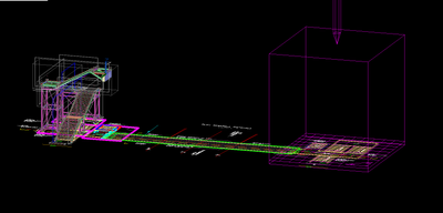

I have a case with a big structure of stairs which I have to mirror them. I have a lot of cameras on the structure, but after mirroring them all, the generated "mirrored" views are the same.
Do you have any solution for getting the views mirrored and avoiding to make cameras again?
I made a simple exemple for understanding, thanks!

Copy and rotate the camera.
roxy92
It's mirrored, not just rotated.
fshaikhQBJPK
From the image you shared, I can see that you use model view boxes as cameras? I don't use them; I was talking about the camera object from advance steel tool palette. I don't know how the boxes work.
roxy92
They work the same. I am trying to avoid working double for a structure which is the same, but just in the mirror. In the magenta box from the right side should be the mirrored structure from the left side.
