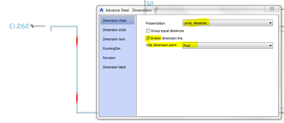

Sometimes Advance will create a detail that has a level dimension as shown in the attached snip. I have wasted a lot of time trying to add this in where AS does NOT put it in automatically, and I have not been successful. I want it to look like the snip.

Try placing a normal linear dimension and set the presentation to "level absolute" and tick the box "Broken Dimension Line". You need at least two points to make a linear dimension so then you set "hide dimensions point" to First or Last to remove the unwanted point.

Here is a picture of how to set the dialog.

"Hide Dimension Point" is in the "Dimension Chain" menu. It works like it should.
