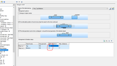

I modified the distance to 1/2" as the screenshot, but the result will shown as 1", if I put 1/4" then it will show 0".
Where can I change the precision of them to show correct value?
Thanks.

Hi @mwwm ,
here doesn't exist any precision settings for this ... sorry i only know metric units.

Thank you, Carl. I believe it still works as 1/2" or 1/4" even it shows incorrectly.
mwwm

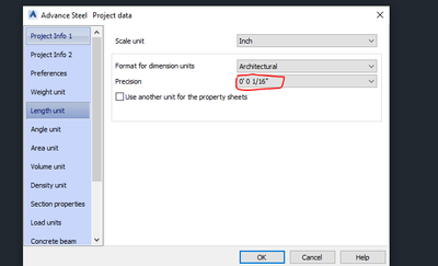

I must change setting somewhere. I checked the previous AS, and found it shows correctly.
mwwm
Okay. I found it is project setting. Now AS is back to normal.
bigcarl5000kg
Super
When you set this in your template file, the problem is solved forever...
